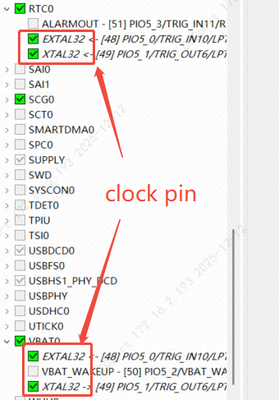

       When I configure shown as below, iRTC can be initialized and work, but the second is wrong.
       1>iRTC pin for external xtal32k
       2>iRTC clock

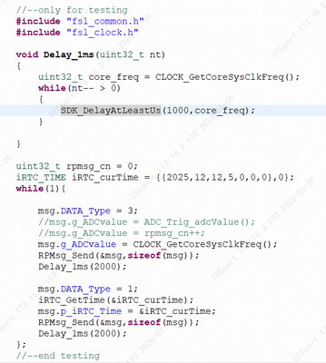

            when I using test code shown as below, the second is wrong.
            Hope you can provide some tips to fix this problem.
            Thanks very much.

      BTW, I found that only enable external 32k crystal, the iRTC can run but the output of second is wrong. But but, when I let the MCU run continuously, iRTC will run accurately later;.
      It is queer to me.
      You can check again.
