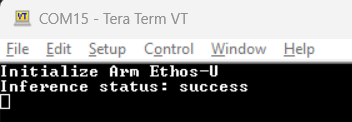

I'm trying to following instructions (from section 6.2.7 ) on building Cortex-M33 firmware from the SDK downloaded.
using GNU arm toolchain 13.x , I'm able to compile the demo application
ethosu_apps
But from uboot when I ran it, I'm seeing error logs in COM/serial port of Cortex M33
Initialize Arm Ethos-U
E: NPU error(s) occured during inference. (ethosu_driver.c:542)
E: NPU status=0x00000804, qread=0, cmd_end_reached=0 (ethosu_device_u55_u65.c:182)
Node ethos-u (number 0) failed to invoke with status 1
E: Invoke failed for inference: job=job (inference_process.cpp:281)
Inference status: failed
I expected it to work as is, can someone help me here ?

Chavira
HI @phanichinimilli!
Thank you for contacting NXP Support!
I tried with the iMX93-QSB and I didn't see errors.
I compiled the example using MCUXPRESSO for VS CODE the version of the SDK that I am using is 2.16.
Best Regards!

Chavira
Hi @phanichinimilli!
I got the next response from the apps team:
I can reproduce identical ethosu_apps_rpmsg.bin startup success from U-Boot (I assume because the rpmsg app doesn't attempt any inferences) and the same ethosu_apps.bin failure on SDK 2.16.000, gcc-arm-eabi-none-10-2020-q4-major (as noted in UG10166) and BSP LF6.6.52-2.2.0. I launched it from U-Boot as follows (the bootaux 0x201e0000 0 address in UG10166 is suspect):
u-boot=> fatload mmc 1:1 ${loadaddr} ethosu_apps.bin
49800 bytes read in 3 ms (15.8 MiB/s)
u-boot=> cp.b ${loadaddr} 0x201e0000 ${filesize}
u-boot=> bootaux 0x1ffe0000 0
## Starting auxiliary core addr = 0x1FFE0000...
u-boot=>
Just as you observed on the Cortex-M33 console:

phanichinimilli
Thanks @Chavira ,
With the suggested change I can see ethosu_apps.bin seems to be working as expected when launched from uboot.
Have you got a chance to look into the issue I've mentioned in post ?
