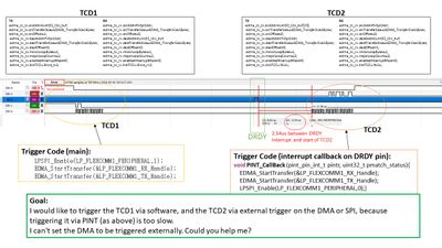

I tried to summarize the issue in one slide
I need to send a SPI command, this message starts an external ADC conversion, when the data is ready a PIN rise up. This pin should be my trigger to start a a new transaction on SPI.  I described this situation trough 2 TCD, and it works! The issue is that I would like to trigger the second TCD with external pin directly. I can set this pin both as a SPI trigger and as a DMA trigger. But I can't get it to work.
This is a simple scenario of my application, I started from this to add piece by piece and complicate it.

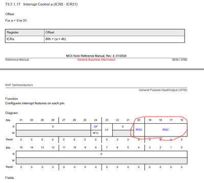

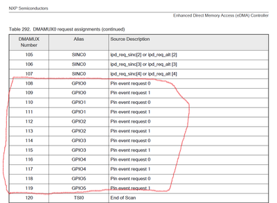

I suppose that the spi of MCX is the master, after it send command to slave spi, the slave spi can output a ready signal. You can connect the ready signal to any GPIO pin, and have the GPIO port which includes the GPIO pin triggers eDMA, then eDMA can write the master spi data register to launch spi transfer,  in this way, you can guarantee that the spi reading data is valid.
The GPIO port(any GPIO signal in the port) can be the trigger source of eDMA, you can set the
The eDMA trigger source with the GPIO port.
Each GPIO pin can generate DMA request0 or request 1 by configuring the ICR[pin] register of a specific PORT.
Hope it can help you
