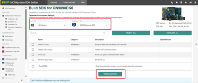

Hello @Xeleqt_Ellan ,
Regarding the EVK you are currently using, I recommend that you refer to the official SDK  provided for setting up your project so that you can focus on the core development tasks rather than getting stuck on setting up the environment or encountering compatibility issues.
You can download the SDK through the following link. Select Board | MCUXpresso SDK Builder (nxp.com)
Search for your hardware and then build SDK.
Choose your system model, select the IDE: MCUXpresso, and pick the features you need.
Drag SDK file to the area above, then you can import SDK examples.
