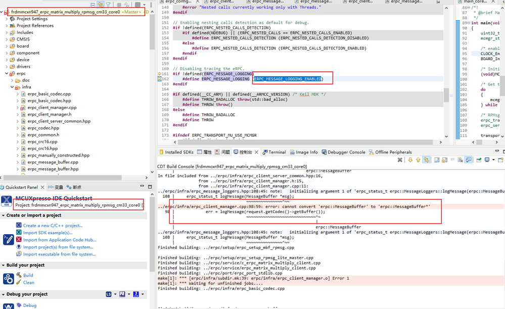

I'm using erpc in a frdm board and found that opening the ERPC_MESSAGE_LOGGING macro reported an error. The attached image shows the detailed error message.image-20241221154950008.png

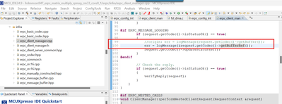

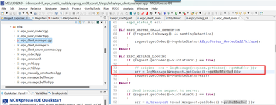

I have indeed reproduced your issue. The `logMessage` function expects a parameter of the `MessageBuffer *` pointer type. However, the previous error message indicated that it was not possible to convert an ordinary `erpc::MessageBuffer` object into an `erpc::MessageBuffer*` pointer type. Therefore, the following workaround can be considered to solve this type mismatch problem: obtain a reference using the `getBufferRef` function and then pass the pointer by taking the address. The code modification is as follows:
In erpc_client_manager.cpp:
By modifying the above code, it can be compiled successfully.
