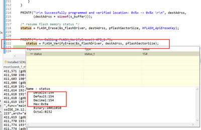

  5. If I try to erase the same sector written before, the FLASH_VerifyErase() returns 154 error code: what is it? The 154 error code is not listed in the MCXN Reference Manual among the possible return codes of the FLASH APIs.
  6. Even if FLASH_VerifyErase() returns 154 error code, the data program and verify are then  successfull: is it normal?

After I confirmed with our internal team,
"The error code 153 and 154 will be added in the latest MCX N RM, the new RM is still under review and will be published on NXP website at the end of Feb or early of March. You can see the description for error code 154 in below figure.

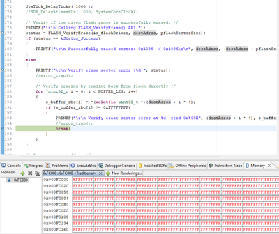

Vagni
OK Alice, error code 154 indicates the flash sector is not erased.
Also my added direct reading back from flash fails in verifying erased sector from the first beginning address (at destAdrss = 0x000FC000 read 0x00000000 instead of 0xFFFFFFFF).
But the debug memory reading reports the flash sector is actually erased:
I added a delay of 1 sec after the FLASH_Erase() call (which never fails), but I get no behavior change.
Anyway, the subsequent flash write is always (and unexpectedly) successful.

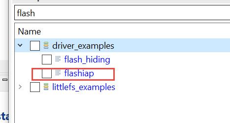

Which version of the SDK do you use? Do you perhaps mean the demo named 'flashiap'?
Alice
4,843 Views
Vagni
Hello Alice,
I am using SDK_2.x_MCXN547 v24.12.00 with MCUXpresso IDE v24.12 and I refer to the \driver_examples\mcxromapi_flashiap_cm33_core0 example.
