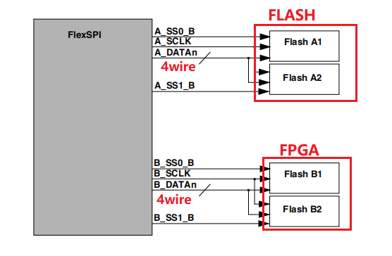

I would like to confirm the usage of Flexspi interface of RT1052 chip:
1. I need to use Flexspi interface to communicate with two devices, namely NOR Flash and FPGA, which correspond to FlexspiA interface and FlexspiB interface respectively, and both use 4-wire communication mode;
2. After the system is powered on, I need to access two devices at the same time. Is this allowed? Specifically, when I am working with FLASH, am I allowed to read and write FPgas?
3.in particular, the communication with the FPGA is a regular 2ms communication, but the operation of FLASH takes a long time, will it affect the communication cycle with the FPGA?
4. Is there a better plan to recommend?
Thank you!

jiaxin
Hi,Harry
1、If we plan to use the RT1052, it has a FlexSPI controller, as shown in the attached figure, still can't access the FPGA when reading and writing FLASH? Can't access independently, must need to wait for the end of the access to the other side of the data?
2、If two tasks with different priorities are set to access two devices, the priority of the task with high real-time requirements is set to high. What should be paid attention to in this case?
Thank you!

Harry_Zhang
1. Yes, you are right.
2. In a FreeRTOS-based system, if you have two tasks with different priorities accessing devices on the same FlexSPI bus,
I think you should use FreeRTOS synchronization mechanisms (e.g., mutexes) to protect access to shared resources like the FlexSPI bus.
If the high-priority task has strict real-time requirements, consider limiting the frequency or duration of FlexSPI accesses by the low-priority task.
