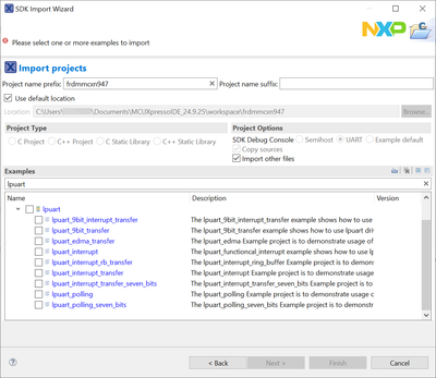

I will look at the example. Just by chance, is there any example that would use FIFO and not use EDMA?
John Adams
4,548件の閲覧回数
EdwinHz
Hi @John_Adams,
Of course, that would be any of the other LPUART examples that we provide in our SDK:
BR,
Edwin.
