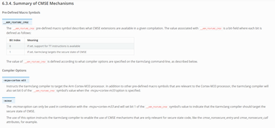

As you know that the TrustZone is a feature of cortex-M33 core, so the ARM defines the macro __ARM_FEATURE_CMSE.
Pls refer to the link:
It define the bit meaning of the __ARM_FEATURE_CMSE compiler macro.
Hope it can help you

I do understand the part covered by the reference you linked so I should be more specific with my question...
