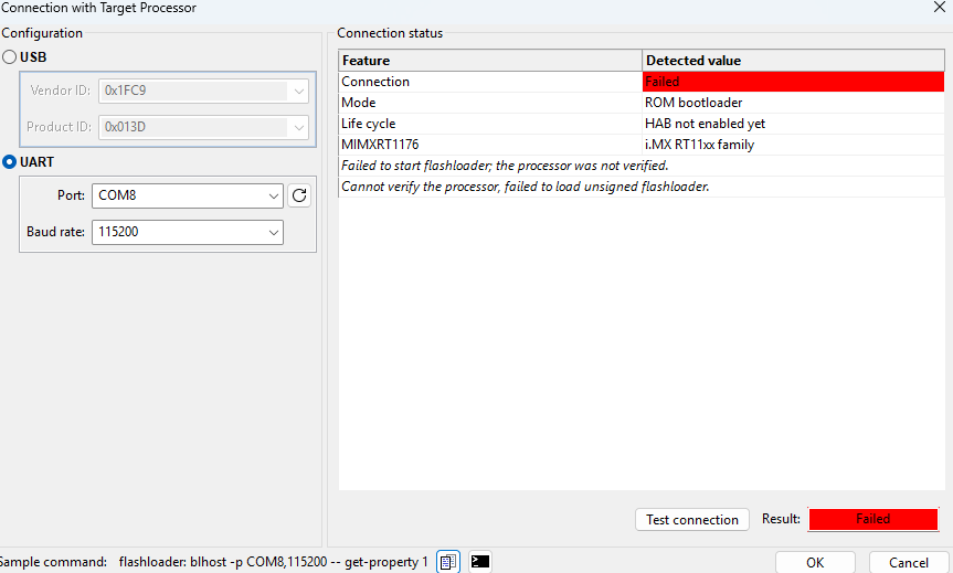

I am trying to connect and flash the board using the Secure Provisioning Tool (SPT) over UART1, but I am unable to establish a connection. When I click on "Test Connection", I get the following errors:
Failed to start flashloader, the processor was not verified.
Cannot verify the processor, failed to load unsigned flashloader.

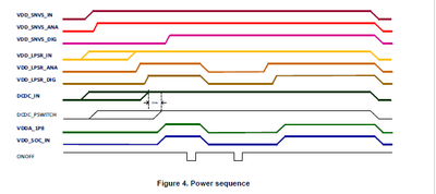

1: Please use an oscilloscope to check if the chip's power-up sequence is correct.

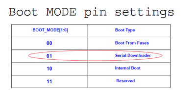

2:when you use Secure Provisioning Tool (SPT),do you set RT1176 chip as serial downloader mode?
3: Please check the BOOT_CFG[0-11] pins setting. You can refer to MIMXRT1170-EVKB board design.

Secure Provisioning Tool uses flashloader application from MCUXpresso SDK. It is distributed in binary form here:
c:\nxp\MCUX_Provi_25.06\bin\_internal\data\targets\MIMXRT1176\flashloader_cm7.srec
There might be needed modifications for you custom board. Use the flashloader example to verify, whether flashloader ir running on your custom board (simply run the flashloader application in the debugger and try to connect from Secure Provisioning Tool via Connection dialog). In case you need any modification, simply re-build the flashloader, override the version in Secure Provisioning Tool.
