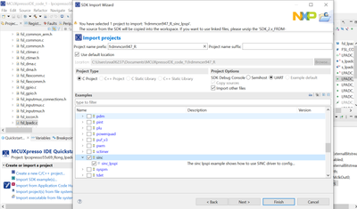

The SDK has the SINC driver and example.
You can download SDK package from the website:
https://mcuxpresso.nxp.com/en
This is the SINC example in SDK.
Because there is NOT the SINC sensor, so this is an simulation example.
Hope it can help you
