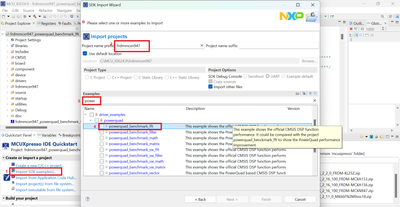

[A2] The frdmmcxn947_powerquad_benchmark_fft demo could be a useful reference for your questions.  By converting and inputting your three-phase current data into an appropriate format, it may meet your needs.
To get the demo, download the FRDM-MCXN947 SDK. Refer to Importing an SDK Package into MCUXpresso IDE  and install it in MCUXpresso. Open it as below picture shows.
