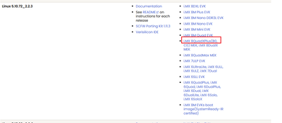

Are you using below boot mode?
Can you try to use sudo before uuu?

Dear Zhiming_Liu
My current setup is as shown:
I really can't find the problem, please help, thank you!

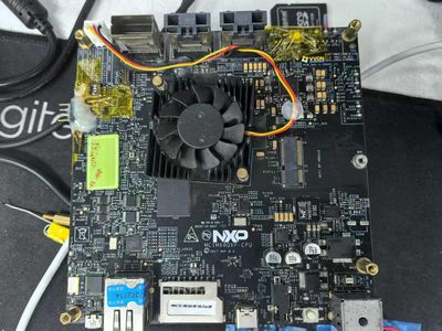

Zhiming_Liu
It seems that you are using i.MX8QXPB0 MEK,can you see 'Si B0 SECO' string around M.2 socket?
You can try to flash B0 binary in this demo image.

Zion
Dear Zhiming_Liu
To be honest, I don't know how to distinguish between c0 and b0, so I took a picture to show you.
1,713 Views
Zhiming_Liu
The i.MX8QXPC0 MEK is not black. You can try to flash B0 image to verify if this is i.MX8QXPB0.
