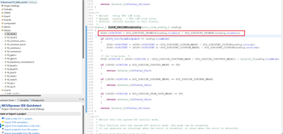

I have used peripherals config tool to configure the Systick to work with cpu_clk divided by 4.
After building the project there are 2 compilation errors, due to the lack of kCPU_CLK_to_SYSTICK and kCLOCK_DivSYSTICK definitions.
I have checked that these definitions are not included in fsl_clock.h file.
Note that I use MCUxpresso IDE 25.6 and SDK 25.09.
The fsl_clock.h file of the mcux-sdk 2.16 available in github includes these definitions, but i not confident in this file because i have found some bugs, for example:
- the are some comments that are incorrect
- CLOCK_FRO12MTrimConfig() function of fsl_clock.c file has this code:
                 SCG0->SIRCSTAT = SCG_SIRCSTAT_CCOTRIM(config.cltrim);
                 SCG0->SIRCSTAT = SCG_SIRCSTAT_CCOTRIM(config.ccotrim);
    and i think that it should be:
                 SCG0->SIRCSTAT = SCG_SIRCSTAT_CLTRIM(config.cltrim);
I have also search the documentation for SDK 25.12, but these definitions are not included.
I can manually modify fsl_clock.h file, but I prefer to have a correct SDK.
Is there a SDK version for FRDM-MCXA153 which includes these definitions?

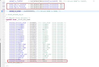

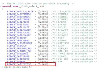

Harry_Zhang
Hi @zorrotz
Yes, i have checked the code.
It is a bug.
I will report it to our SDK team.
If you want to use kCPU_CLK_to_SYSTICK and kCLOCK_DivSYSTICK.
You need to add some code in fsl_clock.h
Harry_Zhang_3-1766042710072.pngHarry_Zhang_3-1766042710072.pngHarry_Zhang_4-1766042747585.pngHarry_Zhang_4-1766042747585.png
Hope this will help you.
Harry

Harry_Zhang
Hi  @zorrotz
I have checked the frdm_mcxa153 v25.09 SDK.
In fsl_clock.c
status_t CLOCK_FRO12MTrimConfig(sirc_trim_config_t config)
    SCG0->SIRCTCFG = SCG_SIRCTCFG_TRIMDIV(config.trimDiv) | SCG_SIRCTCFG_TRIMSRC(config.trimSrc);
    if (kSCG_SircTrimNonUpdate == config.trimMode)
        SCG0->SIRCSTAT = (SCG0->SIRCSTAT & ~SCG_SIRCSTAT_CLTRIM_MASK) | SCG_SIRCSTAT_CLTRIM(config.cltrim);
        SCG0->SIRCSTAT = (SCG0->SIRCSTAT & ~SCG_SIRCSTAT_CCOTRIM_MASK) | SCG_SIRCSTAT_CCOTRIM(config.ccotrim);
    /* Set trim mode. */
    SCG0->SIRCCSR = (SCG0->SIRCCSR & ~(SCG_SIRCCSR_SIRCTREN_MASK | SCG_SIRCCSR_SIRCTRUP_MASK)) | (uint32_t)config.trimMode;
    if ((SCG0->SIRCCSR & SCG_SIRCCSR_SIRCVLD_MASK) == 0U)
        return (status_t)kStatus_Fail;
    if ((SCG0->SIRCCSR & SCG_SIRCCSR_SIRCERR_MASK) == SCG_SIRCCSR_SIRCERR_MASK)
    if ((SCG0->SIRCCSR & SCG_SIRCCSR_TRIM_LOCK_MASK) == 0U)
    return (status_t)kStatus_Success;
You can refer to it.

zorrotz
Hi Harry
Yes, CLOCK_FRO12MTrimConfig() function in SDK v25.09 is OK, but the problem is that this SDK version doesn't have kCPU_CLK_to_SYSTICK and kCLOCK_DivSYSTICK definitions.

Harry_Zhang
Hi @zorrotz
It is a bug.
Harry
2,011件の閲覧回数
zorrotz
Thank you Harry!
I will modify fsl_clock.h file.
