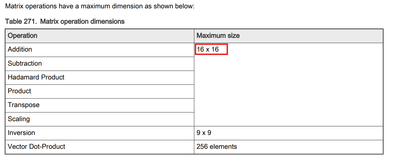

I am running example frdmmcxn947_powerquad_cmsis and extended size a bit.
Now memory gets corrupted around the locals so it looks to me like powerquad writes outside the expected memory.

Hello @Peter19 ,
Thanks for your post. The reason is that there are restrictions on the dimensions of the power_quad matrix operations. It only supports a maximum size of 16 * 16, and setting the row to 32 is not reasonable. You can find the detailed information in the Reference Manual. See the figure below.
Hope it can help you.

Peter19
Hello @Celeste_Liu
It is not obvious to me that 32x1 is not supported since it is much smaller than 16x16...
/Peter
2,722件の閲覧回数
Celeste_Liu
Hello @Peter19 ,
What I mean is that neither a single dimension of the matrix, be it the row or the column, can exceed 16. If you change 32x1 to 16x2, it will work. Similarly, I've tested the maximum size of 16x16 and there was no problem.
