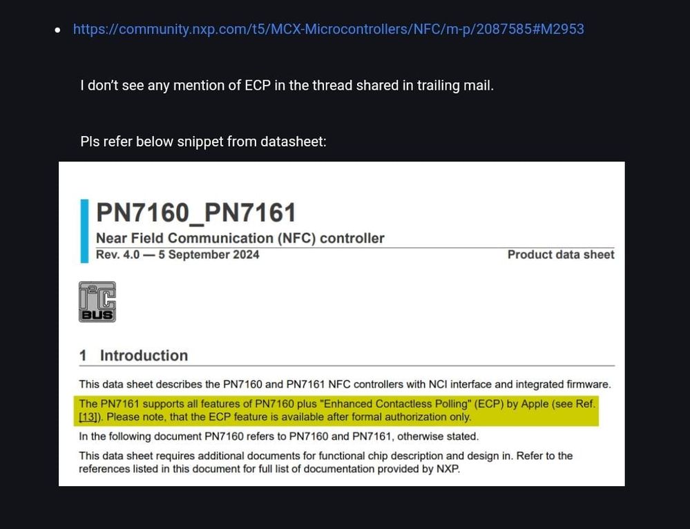

do we need any approval from Apple for programing firmware on LPC82x series for NFC application.

 ECP is a proprietary extension developed by Apple. You need to get approval from Apple.
2,851 Views
Khutwad
do we need to put any code for ECP in firmware code? if not going anything why we need approval ?
2,808 Views
ZhangJennie
You only need to integrate the ECP code when your NFC device needs to perform  ​​mutual authentication with the Apple SE chip.
For more, I suggest you check with Apple directly.
