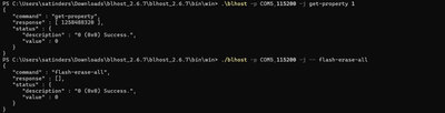

I'm encountering an issue when trying to program or erase the MCXN236 using MCU-Link. Below is the log output:
Nc: Using SOFT reset to run the flash driver
Nc: Flash variant 'MCXNxxx (1024KB) (Secure)' detected (1MB = 128*8K at 0x10000000)
Nc: Closing flash driver MCXNxxx_S.cfx
Pc: ( 65) Chip Setup Complete
Pc: ( 70) License Check Complete
Nt: Loading 'GUI.bin' Binary 0x00000000 len 0x11068
Nc: Opening flash driver MCXNxxx.cfx
Nc: VECTRESET requested, but not supported on ARMv8-M CPUs. Using SOFTRESET instead.
Nc: Flash variant 'MCXNxxx (1024KB)' detected (1MB = 128*8K at 0x0)
Pb: 1 of 1 ( 0) Writing sectors 0-8 at 0x00000000 with 69736 bytes
Ps: ( 0) at 00000000: 0 bytes - 0/69736
Wc: failed read ChecksumSectors message readyness - rc Em(12). Target rejected debug access at location 0x040048D0
Wc: failed to send op EraseSector message - rc Em(12). Target rejected debug access at location 0x040048B8
Nc: Closing flash driver MCXNxxx.cfx
Nc: state - running or following reset request - re-read of state failed - rc Nn(05). Wire ACK Fault in DAP access
Wc: failed to send op Terminate message - rc Em(12). Target rejected debug access at location 0x040048B8
Pb: (100) Writing Flash ended with an error.
Ed:05: File 'GUI.bin' load failure: Em(12). Target rejected debug access at location 0x040048B8
Pc: (100) Target Operation Failed
Nc: error closing down debug session - Nn(05). Wire ACK Fault in DAP access
The ISP bootloader appears to be working. I can send commands to the memory using it but the code does not run after flashing.

@sstcor  , Below is a sample flash script using blhost — NXP’s command-line tool for communicating with the bootloader — to fully erase and program the flash on an MCXN236 via ISP mode (UART or USB, depending on your setup).
1. Full Chip Erase via ISP (blhost script)
# Connect via UART or USB first # Replace COMx with your serial port (e.g., COM3 on Windows or /dev/ttyUSB0 on Linux) blhost -p COMx,115200 -- get-property 1 blhost -p COMx,115200 -- flash-erase-all
If this works, your flash is now clean.
2. Flashing New Firmware (GUI.bin)
blhost -p COMx,115200 -- write-memory 0x00000000 GUI.bin blhost -p COMx,115200 -- execute 0x00000000
This writes your firmware to the start of flash (address 0x00000000) and then tells the MCU to execute from there.
Note: If your GUI.bin is an image from MCUXpresso or GCC, ensure it is a proper binary file and not in ELF or HEX format. If needed, convert with:
arm-none-eabi-objcopy -O binary GUI.elf GUI.bin
3. Quick Image Validity Checklist
Before flashing, check that:
  • The first 8 bytes of GUI.bin contain a valid stack pointer and reset vector.
  • You're not configuring any memory regions (e.g., TrustZone, MPU) that might restrict access without properly initializing them.
  • If Secure Boot is enabled, the image is signed or provisioned correctly.
Would you like me to generate a minimal example main.c that’s safe to flash and test on the MCXN236?

sstcor
I am getting this error when I enter the "execute" command.
4,019 Views

sstcor
Hi Ashutosh, I tried erasing the microcontroller in ISP mode but no success. I still can't access the microcontroller using debug port.
