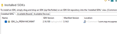

Dear NXP team,
I am checking out this example:
https://github.com/nxp-appcodehub/dm-fashion-mnist-recognition-on-mcxn947/tree/df78550534b2a30410f56...
The example works well on my FRDM-MCXN947. When I try to add one a PWM SDK component through the "Manage SDK Components" tool, the compilation breaks with many errors.
Is there anyway to get about this situation?
By the way, I am using MCUXpressio IDE 24.9 with SDK version 2.16.1.
Thanks.

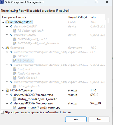

I download the example from GitHub and imported it to mcuxpresso.
Then i try to add PWM driver through SDK manager.
It asked for updating the source code, which I agreed. After that, many compilation breaks.
Thanks.

Hi @wklee
Can you try manually adding  pwm driver into this project?
Harry

Hi @wklee
May i ask if you create the new project?
How can i reproduce this issue?
