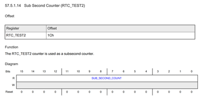

      I find that MCXN547 has subsecond function register for iRTC, and I consider using this function to record millisecond.

1>subSecond register in MCXN reference manual

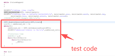

2>test code
based on example: frdmmcxn947_irtc_cm33_core0
hardware: FRDM-MCXN947
IRTC_EnableSubsecondCounter(RTC,true);
uint32_t subSecond_cnt = 0;
while(1){
subSecond_cnt = IRTC_GetSubsecondCount(RTC);
PRINTF("subSecond Counter is %d.\r\n",subSecond_cnt);
//intervals time
uint32_t i,j;
for(i=0;i<6534;i++)
for(j=0;j<6232;j++){
__NOP();
3>test result
    the parameter "subSecond_cnt" is still 0.

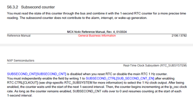

Hi @jimmyli
The Subsecond counter  use these register, not RTC_TEST2.
If you want to use is,
Please refer to  chapter 56.3.2 Subsecond counter
You can try.
Harry

According to the RM.
There are two important points to note.
1. You must independently enable the field by writing 1 to SUBSECOND_CTRL[SUB_SECOND_CNT_EN] after enabling RTC.CTRL[CLKOUT] (see chip-specific RTC_SUBSYSTEM for more information) to select the 1 Hz clock output.
2.In RTC.CTRL[CLKO_DIS]  you should select The selected clock is output to other peripherals. 0b

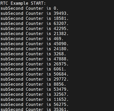

3,373件の閲覧回数
jimmyli
Contributor V
Hi Harry,
      Thanks very much for your help!
      I have checked with your code, and subsecond can work now.

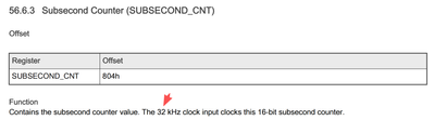

      But I have a question that when I convert subsecond counter to minisecond, the value seems wrong.
      Eg: 1>default clock source for subsecond counter is 32KHz;
           2>Minisecond Value = ( 1 / 32KHz ) * subsecond counter = 1/32000 x 53479 = 1.67 (s) > 1(s)
      Do I calculate it wrongly ?

Harry_Zhang
Hi @jimmyli
I think your calculation method is correct,
So i need to confirm with the internal team.
Harry
