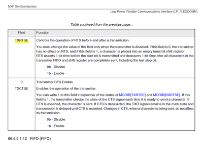

Maybe, the MODEM IrDA (MODIR) register seems to have all the flags I was looking for LPUART hardware flow control and RS485 transceiver driver enable, right?
The TXCTSSRC, TXCTSC, TXCTSE flags configure the LPUART transmitter CTS input function.
The RXRTSE, RTSWATER flags configure the LPUART receiver RTS output function.
The TXRTSE, TXRTSPOL flags configure the LPUART transceiver driver enable output function.
The fsl_lpuart SDK driver seems to handle only the hardware flow control configuration. I have to make myself the LPUART configuration for RS485 transceiver driver enable, right?
2,369 Views
xiangjun_rong
I suppose that you have to set the TXRTSE bit in the MODIR register, after you set the bit, when the uart transfers character, the RTS_b will be asserted.
I suppose that the uart driver in SDK does not includes the hardware flow control code. You have to develop the code yourself.
