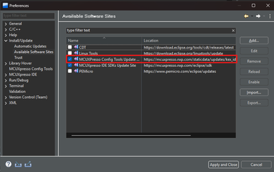

A) The MCUXpresso version always tells me that this device is not supported, and to check my internet connection. I have downloaded the latest SDK (21.12.00 built 03-21-2026) and the same issue - cannot open the pin, clock, or TEE. I can use this tool for the MCXE31B variant but not the MCXE316 smaller chip.

Regarding your point A: The Config Tools updates is by default disable in MCUXpresso IDE, if you want to enable it, go to Windows -> Preferences -> Install/Update -> Available Software Sites, mark the MCUXpresso Config Tools click Apply and Close.
Next go to Help -> Check for Updates
With this you will updates Config Tools to the newest version for MCXUXpresso IDE and you were able to use it for the MCXE316.
Please note that TEE is disabled for all MCXE31x family devices at Config Tools, so you would need to implement your own solution.
