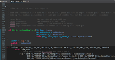

I would like to use the PWM Capture feature.
However, there doesn't seem to be a relevant example in the SDK there is only a sample for PWM output.
I noticed there is a Capture API in the Driver, but my attempts so far have not been successful.
I would like to ask if there are any other related samples that I can refer to.
My code is as follows:
int main(void)
    BOARD_InitHardware();
    PRINTF("FlexPWM input capture only\r\n");
    pwm_config_t pwmConfig;
    PWM_GetDefaultConfig(&pwmConfig);
    pwmConfig.pairOperation = kPWM_Independent;
    pwmConfig.enableDebugMode = true;
    PWM_Init(BOARD_PWM_BASEADDR, kPWM_Module_0, &pwmConfig);
    // Setup Input Capture
    pwm_input_capture_param_t captureParams = {0};
    captureParams.captureInputSel = 0;
    captureParams.edge0 = kPWM_RisingEdge;
    captureParams.edge1 = kPWM_FallingEdge;
    captureParams.enableOneShotCapture = false;
    captureParams.fifoWatermark = 0;
    captureParams.edgeCompareValue = 0;
    PWM_SetupInputCapture(BOARD_PWM_BASEADDR, kPWM_Module_0, kPWM_PwmX, &captureParams);
    PWM_StartTimer(BOARD_PWM_BASEADDR, kPWM_Control_Module_0);
    while (1)
        uint16_t captured_cval0 = BOARD_PWM_BASEADDR->SM[kPWM_Module_0].CVAL0;
        PRINTF("Capture Value 0 Register: %u\r\n", captured_cval0);
        uint16_t captured_cval1 = BOARD_PWM_BASEADDR->SM[kPWM_Module_0].CVAL1;
        PRINTF("Capture Value 1 Register: %u\r\n", captured_cval1);
        SDK_DelayAtLeastUs(100000, SDK_DEVICE_MAXIMUM_CPU_CLOCK_FREQUENCY);
Thank you.

I figured it out.
int main(void)
    //pwmConfig.prescale = kPWM_Prescale_Divide_1;
    pwmConfig.reloadLogic 	= kPWM_ReloadPwmFullCycle;
    if( PWM_Init(BOARD_PWM_BASEADDR, kPWM_Module_0, &pwmConfig)== kStatus_Fail){
    	PRINTF("Can't initialize PWM\n");
    	return 0;
    //captureParams.fifoWatermark = 0;
    //captureParams.edgeCompareValue = 0;
    //PWM_SetPwmLdok(BOARD_PWM_BASEADDR, kPWM_Control_Module_0, true);
    while (1)
        uint16_t rising = BOARD_PWM_BASEADDR->SM[kPWM_Module_0].CVAL0;
        uint16_t falling = BOARD_PWM_BASEADDR->SM[kPWM_Module_0].CVAL1;
        uint16_t high = falling > rising ? falling - rising : (falling + 0x10000) - rising;
        PRINTF("rising: %u  falling: %u  high: %u\r\n",rising, falling, high);
