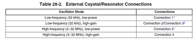

MCXC44X Sub-Family Reference Manual (page 461) describes external crystal (or resonator) connections. Are 3 type of configuratons (Connection 1 to Connection 3).
Why MCXA153 Reference Manual hasn't any informations of external crystal and capacitors configuratons?
In FRDM-MCXA153 schematic is connection with 18pF capacitors and 8MHz crystal.

Hello @bogdanurbanczyk,
You can find the oscillator frequency specifications for the crystal in Section 3.3.2.2 of the datasheet. Additionally, the section you mentioned includes a table that outlines the supported crystal frequency ranges and the different connection options available, depending on your application:
On the other hand, the load capacitor values should follow the crystal or resonator manufacturer's recommendations, as referenced in Table 20: "Oscillator DC Electrical Specifications" of the datasheet. Please keep the following recommendations in mind:
  • If the load capacitors (Cx, Cy) are greater than 30 pF, use Connection 3.
  • When using the low-frequency oscillator (RANGE = 00), the integrated capacitors can provide Cx and Cy.
