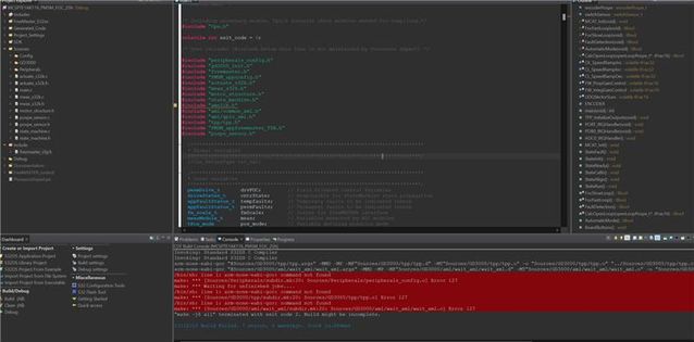

i imported example from MCSPTE1AK116 but i got error(refer image)when i build project.
 #MCPTE1AK116
7 Replies
2,655 Views
_Leo_
I must admit that I can't distinguish the text from your image. Please share a new one, preferably with a light theme, which is more distinguishable when sharing IDE screenshots.

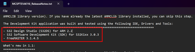

Meanwhile, application software MCSPTE1AK116-SW Rev 1.1 works with S32DS for ARM 2.2 and SDK for S32K1xx 3.0.3.
Please make sure you are working with these versions.

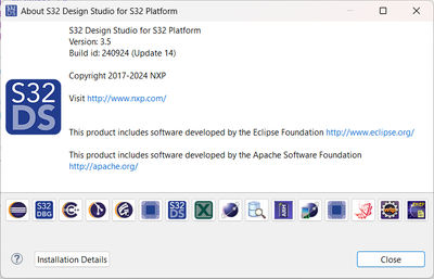

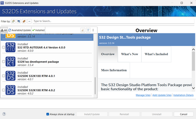

Durgaprasad02
Hi Leo,
Error  getting ;
Software version:
SDK Package :
Could please if any Motor control example code for S32k118.
thank you!!

_Leo_

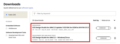

Please download the following IDE and update from S32DS-ARM page -> Downloads section, in order to run the MCSPTE1AK116-SW Rev 1.1:
On the other hand, there is no such demo for S32K118, just for S32K116, for migration you just need to consider their differences in Feature comparison section of datasheet.

Durgaprasad02
Hi leo,
I've install S32 Design Arm Version below given error coming.
2,582 Views
_Leo_

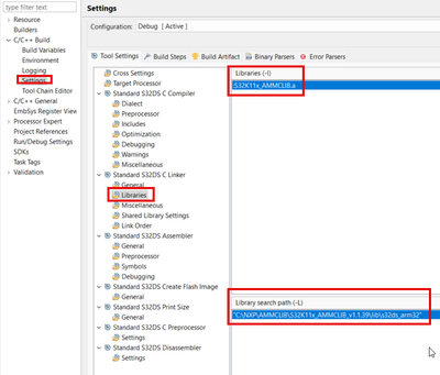

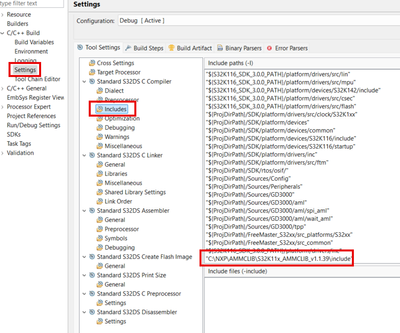

GFLIB is included in AMMCLIB. Please, set your library paths accordingly your files location in project settings.
Includes and also libraries paths:
2,554 Views
Durgaprasad02
Hi Leo,
The settings are already as per your suggestion.
