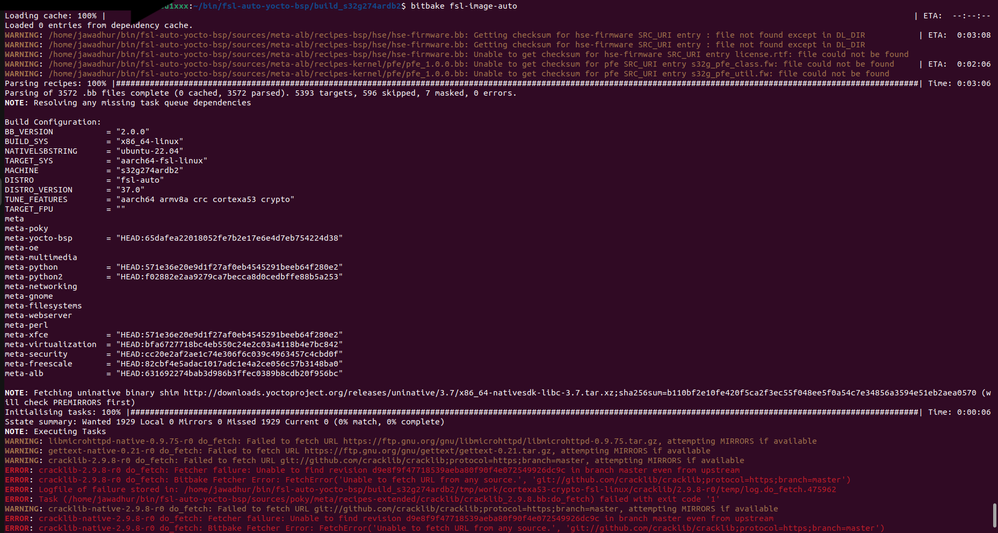

I am trying to bring BSP37.0 linux software into the Bootable SD card I am trying to do it via S32G VNP RDB2 Board I am facing up some issue in the installation how can i resolve this issue
I tried installing in different supporting package this error persist
due to this error the Expected image file is not getting created so i am unable to keep the files into the BSP Package into the SD card
What are the others steps need to be taken here ??
what are the supporting packages need to be added ??

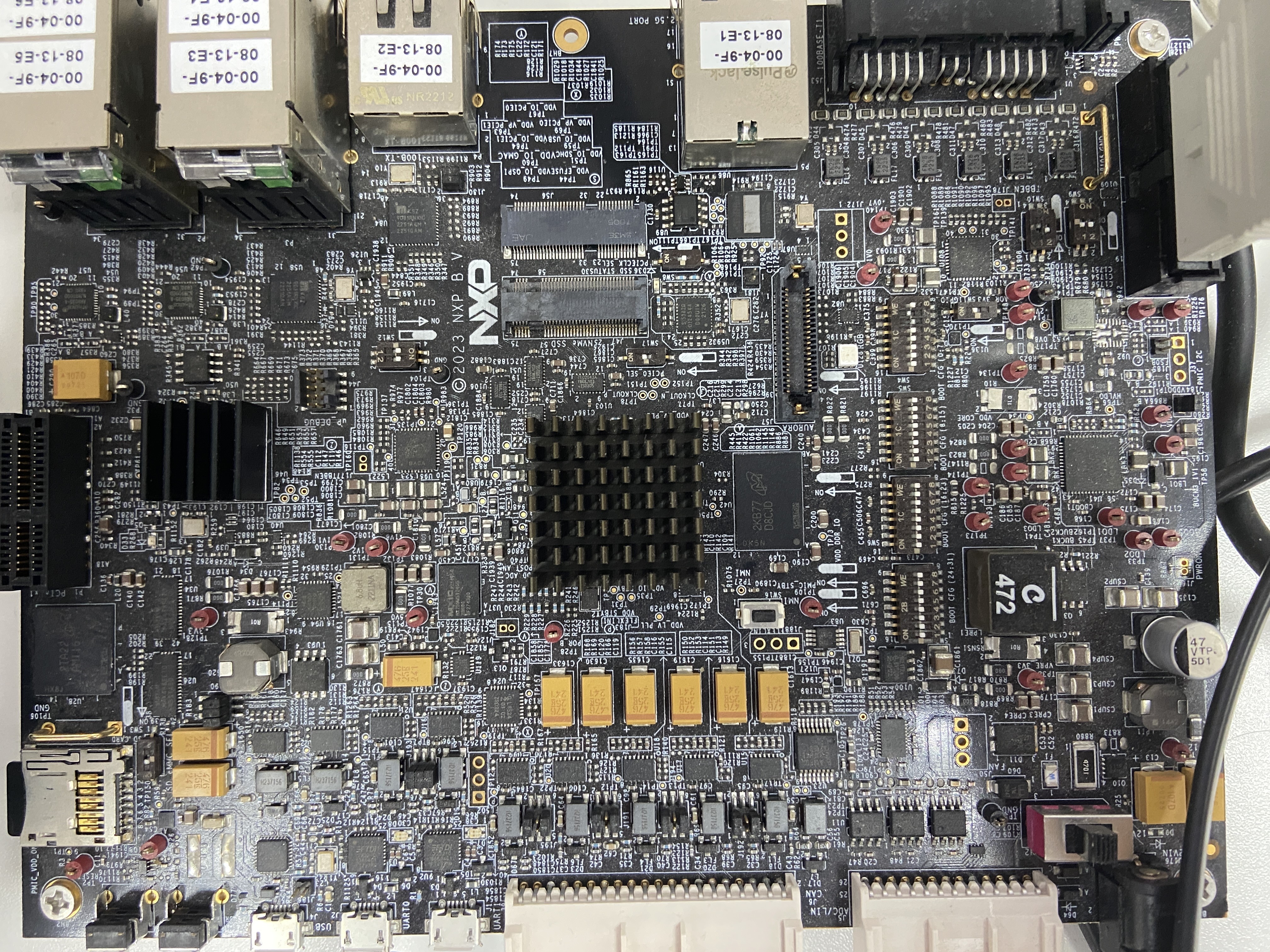

Do you want to share the picture of board for view the pins which gets setted up in the S32G-VNP-RDB2 Board?
FYI, i have setted up the pins mentioned in document BSP43.0 User manual where SW3, SW4, SW5, SW6, SW7, SW9, SW10 so these pins has been setted up according to the Manual
I am not sure what the other pin status should i need to bring the switch pins to default configuration. if it needs to be brought to default configuration what is the pin status for default configuration.

The reason I want to check the photo of your board is to check the board version and the switch settings on it. it is preferred for sharing a photo of your board used.

I have sent you the Bard Pictures

I just checked the pictures you shared, seems issues on the switches settings, would you mind resetting them referencing the picture I attached?

As you mentioned it i have setted up in the default configuration you mentioned in picture when i tried booting the device it was able to boot it on the configuration from SD card. and it was working fine
Can you confirm me once is this the configuration setup for the Board or its just a default configuration of the device setup
But anyway it was able to boot it from SD card

The settings I provided is the default switch settings for booting the RDB2 via SD, if you want to boot the RDB2 via QSPI or other method, the switches should be changed.

It is possibly caused on the repo changes from the 3rd packages from the web, would you mind trying the following modifications?
diff --git a/meta/recipes-extended/cracklib/cracklib_2.9.8.bb b/meta/recipes-extended/cracklib/cracklib_2.9.8.bb
index 786940a7e0..a3db6eb394 100644
--- a/meta/recipes-extended/cracklib/cracklib_2.9.8.bb
+++ b/meta/recipes-extended/cracklib/cracklib_2.9.8.bb
@@ -9,7 +9,7 @@ DEPENDS = "cracklib-native zlib"
EXTRA_OECONF = "--without-python --libdir=${base_libdir}"
-SRC_URI = "git://github.com/cracklib/cracklib;protocol=https;branch=master \
+SRC_URI = "git://github.com/cracklib/cracklib;protocol=https;branch=main \
           file://0001-packlib.c-support-dictionary-byte-order-dependent.patch \
           file://0002-craklib-fix-testnum-and-teststr-failed.patch \
If additional issues, try installing the following packages with the apt command, and then rebuild it for another trial
sudo apt-get install swig python3-dev meson ninja-build
I hope it will help.
Chenyin

I am still facing up with the same issue
What are the other possibility to resolve this issue
can you give me step wise installing and changes ? whether for BSP43.0 version whether it is resolved there??
The below is the terminal output

WARNING: cracklib-2.9.8-r0 do_fetch: Failed to fetch URL git://github.com/cracklib/cracklib;protocol=https;branch=master, attempting MIRRORS if available
ERROR: cracklib-2.9.8-r0 do_fetch: Fetcher failure: Unable to find revision d9e8f9f47718539aeba80f90f4e072549926dc9c in branch master even from upstream
ERROR: cracklib-2.9.8-r0 do_fetch: Bitbake Fetcher Error: FetchError('Unable to fetch URL from any source.', 'git://github.com/cracklib/cracklib;protocol=https;branch=master')
ERROR: Logfile of failure stored in: /home/jawadhur/fsl-auto-yocto-bsp/build_s32g274ardb2/tmp/work/cortexa53-crypto-fsl-linux/cracklib/2.9.8-r0/temp/log.do_fetch.15552
ERROR: Task (/home/jawadhur/fsl-auto-yocto-bsp/sources/poky/meta/recipes-extended/cracklib/cracklib_2.9.8.bb:do_fetch) failed with exit code '1'
WARNING: cracklib-native-2.9.8-r0 do_fetch: Failed to fetch URL git://github.com/cracklib/cracklib;protocol=https;branch=master, attempting MIRRORS if available
ERROR: cracklib-native-2.9.8-r0 do_fetch: Fetcher failure: Unable to find revision d9e8f9f47718539aeba80f90f4e072549926dc9c in branch master even from upstream
ERROR: cracklib-native-2.9.8-r0 do_fetch: Bitbake Fetcher Error: FetchError('Unable to fetch URL from any source.', 'git://github.com/cracklib/cracklib;protocol=https;branch=master')
ERROR: Logfile of failure stored in: /home/jawadhur/fsl-auto-yocto-bsp/build_s32g274ardb2/tmp/work/x86_64-linux/cracklib-native/2.9.8-r0/temp/log.do_fetch.15560
ERROR: Task (virtual:native:/home/jawadhur/fsl-auto-yocto-bsp/sources/poky/meta/recipes-extended/cracklib/cracklib_2.9.8.bb:do_fetch) failed with exit code '1'
NOTE: Tasks Summary: Attempted 1408 tasks of which 1159 didn't need to be rerun and 2 failed.
Summary: 2 tasks failed:
Summary: There were 2 WARNING messages.
Summary: There were 4 ERROR messages, returning a non-zero exit code.

Hello, @Atkinson
Thanks for your post.
1. May I know if you had such issue during building pure BSP37 BSP? any modifications on the source?
2. Ubuntu version on your building host is?
Chenyin

i have copied the file fsl-image-auto-s32g274ardb2.sdcard by the below command
export DEVSD=/dev/sdb
sudo dd if=./ fsl-image-auto-s32g274ardb2.sdcard  of=${DEVSD} bs=1M && sync
sudo cmp ./fsl-image-base-s32g274aevb.sdcard ${DEVSD}
So these commands has been executed
I have setted up switch configuration according the Board setup as S32GVNPRDB2 board
But when i booted up the board it should boot from SD card i have connected in UART1 cable Opened Teraterm / Putty configured in 115200 baud Rate erro bit and parity is setted!!
But i am not seeing the the linux terminal so How can i resolve the issue!!

Hi @chenyin_h
Thanks for the reply
1. Yes, I followed up the procedure according to the BSP37.0 Quick Start Guide and User manual for BS37.0. No more changes followed up the steps as it is same mentioned in the File i tried even Different Laptop but this issue continuous. If possible you can also give me a Valid Procedure steps which works fine
2. I tried building in Ubuntu 20.04 and also i tried in different version Ubuntu22.04 also but this issue occurs
Atkinson
タグ(1)
