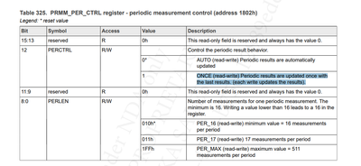

But when i try to read the volt measurements continuously, able to read it at very first time only. In PRMM_PER_CTRL register, i checked with both AUTO and ONCE ctrl. Steps follows as below.
1. Configure done. (Periodic Measurement)
2. Check PERRDY bit from PRMM_MEAS_STAT.
3.Read the volt data from PRMM_PER_VC0(Success)
4. Again step2 (Here PERRDY bit is not set in both Auto and once mode). (For Once mode, as per data sheet we followed the seq.).
Is there any sequence or configuration or steps did i miss for reading data continuously? Any reference code for cell volt measurement.
