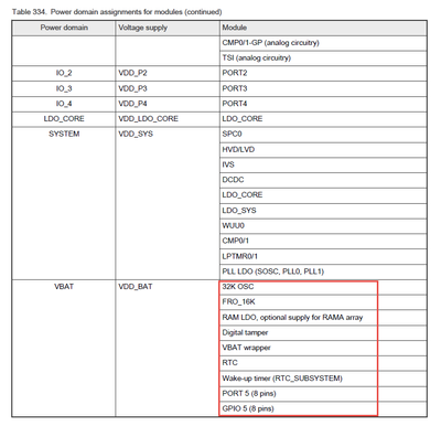

For example, I was looking for some information about the RTC:
• Deep Power Down: Down to 2.0 μA, 5.3 ms wake-up (RTC enabled 8 KB RAM and Reset pin enabled, @25 C).
There is no kind of information correlated to RTC by himself!
As, the RTC backup battery, also is used to supply the voltage to the PORT5.
1 - The PORT5, when the system has the main VCC_ have some kind of internal redundancy for supplying the working voltage, or not, the working voltage is assumed as backup battery, only, and because of that we have to put that (stupid MIS-projected) external diode assembly for redundancy between mains power VCC and backup battery, for non having consumption from the battery when the system working voltage is present! I understand by the UM that the PORT5 have important hardware, for example the needed one for RTC clock crystal frequency generation, but what about the other (no sense in this condition) hardware?
Willn't they drain the battery, how to work with that and so on?
Could, someone, please, helping me on figuring out where to find some more precise information??

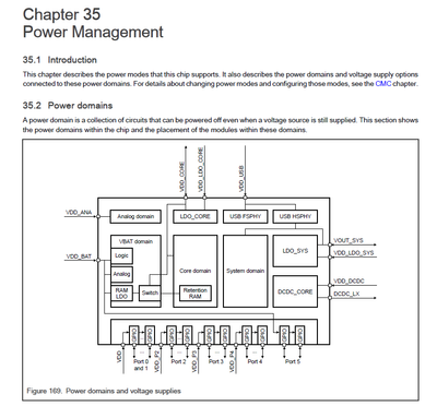

Pls refer to section Chapter 35 Power Management
As the above power domain description, the voltage of VDD_BAT power supply provides logic voltage for PORT5 pins.
These are the modules which the VDD_BAT provide power.
Unfortunately, there is not the other public doc which describes the power part for MCXN94x.
