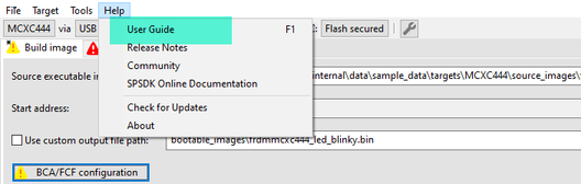

We just released MCUXpresso Secure Provisioning Tool v25. I believe the tool provides security settings for the MCX C that you could find really useful. Below an ilustrative image, where I changed the MCU Life cycle from Unsecure to Flash secure.
As you can see in the BCA/FCF settings,  the FSEC setting  enabled according to Flash secured life cycle.
The SPT, for short. creates bootable and secure images, you can provide a sample image for the MCX C or your custom image. The tool requires connection to the MCU over USB/UART.
For more details about the SPT use, please refer to sections:
6.10 MCX C041/C242/C444 device workflow
6.10.3.3 Life cycle for MCX C041/C242/C444 devices
of the MCUXSPTUG , you can get it easily by doing this:
We can conclude that you can manually edit flash security settings for the MCU using the MCUXpresso IDE, however, we leveraged this to the MCUXpresso Secure Provisioining Tool
