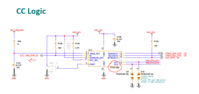

I couldn't find the USB_OTG1_ID pin in MIMXRT1046XFQ5B processor, does that means by default the USB controller behaves as HOST? We are using this processor to build a custom USB host to get data from other USB devices.

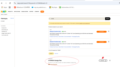

Any contacts from where we could buy MIMXRT1046XFQ5B-EVK boards?

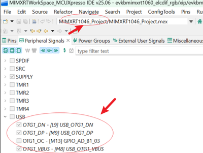

one more clarification is, if the USB_OTG_OC not connected and left it floating, work for USB host only application?

Yes, you can left USB_OTG_OC  pin floating,  and you can also leave this pin uninitialized in the code.

From the EVK design files I see it uses a CC logic IC PTN5150A, but if I want the MIMXRT1046XFQ5B to only behave as host can I exclude using this IC? and then by default does the MCU MIMXRT1046XFQ5B USB Mode is HOST?

Yes, You can choose not to use USB type-C CC logic IC.
When the RT1046 is required to operate only as a USB Host, a direct implementation with a Type-A receptacle is sufficient.
In software, Please explicitly configure the USB role as Host mode.
Please ensure the RT1046 board provides stable VBUS power to the USB port.

Yes, There is no USB_OTG1_ID pin in MIMXRT1046XFQ5B processor USB peripheral , However, you can use other Chip IO to realize the function.
The USB in MIMXRT1046XFQ5B processor still support Host or Device mode.
I suggest you can refer to MIMXRT1046-EVK design.
https://www.nxp.com/search?keyword=rt1046&start=0
