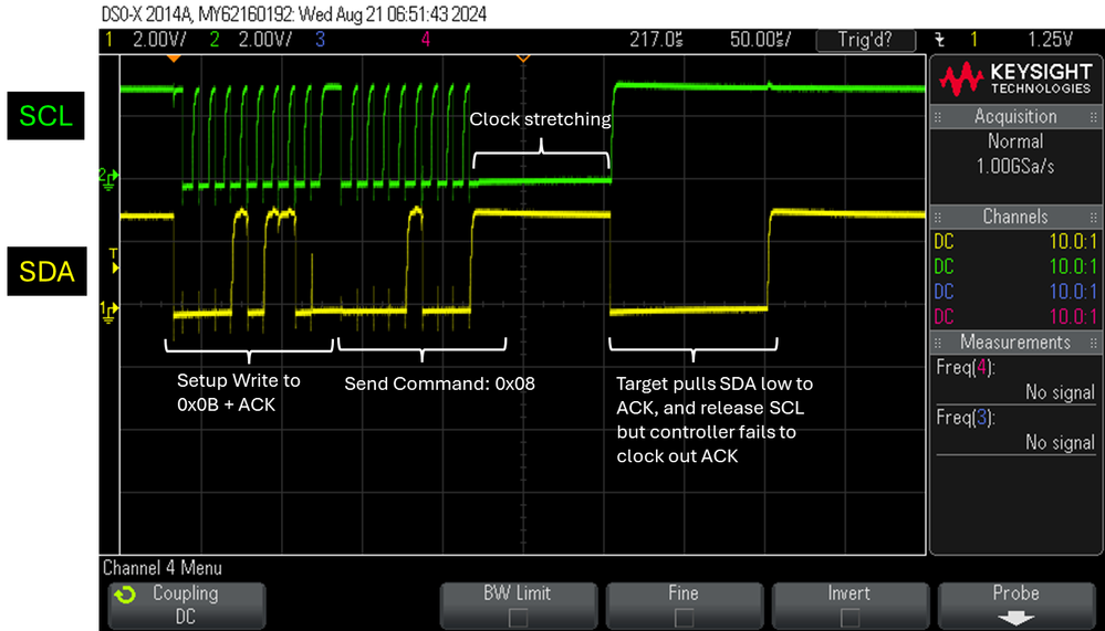

I am trying to use the I3C peripheral on the FRDM-MCXA153 to communicate with an I2C target that requires clock stretching. I have added 10k pull-up resistors at R61 and R62 as instructed here https://community.nxp.com/t5/MCX-Microcontrollers/I3C-SDA-and-SCL-pin-configured-for-Pullup-Enabled-...). This does seem to get I2C communication started. The I2C target device ACKs its address, and I can successfully send a command to the device. The device then holds the clock low while preparing its response. However, when the target finally pulls SDA low to ACK that its response is ready and then releases SCL, the MCXA153 controller fails to resume clocking.
Is there a setting that is necessary to prevent this kind of timeout?
I am using the fsl_i3c driver. The write operation is performed by I3C_MasterTransferBlocking. That function calls I3C_MasterSend at line 1974 in order to send the command byte 0x08. Following the write to the controller data byte register, I3C_MasterWaitForComplete(base, false) is called (line 1558). This returns a result of 7903 (kStatus_I3C_WriteAbort). How do I get the controller to wait until the clock stretching is complete to check for the ACK?

I am aligned with Design team, MCXA153 I3C doesn't support I2C stretch function.
MCXA156 I3C supports I2C stretch function.

With the above changes to attempt Open Drain I2C communication (to allow clock stretching by the target), the communication looks like that from the original post:
The target device ACKs its address, so the controller sends the query temperature command (0x08). The target then attempts clock stretching, but when it finally pulls SDA low to ACK and releases the SCL, the controller fails to clock out the ACK. I3C_MasterTransferBlocking returns with a result of 7903 (kStatus_I3C_WriteAbort /*!< The slave device sent a NAK in response to a write. */)
