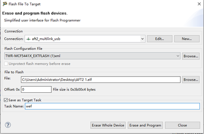

MCU : MCF54415
tool is : Multilink
flash device : MT29F2G16A
select TWR-MCF5441X_EXTFLASH.xml.
I click" erase whole device "
the result(could not find the flash ID) is as below:

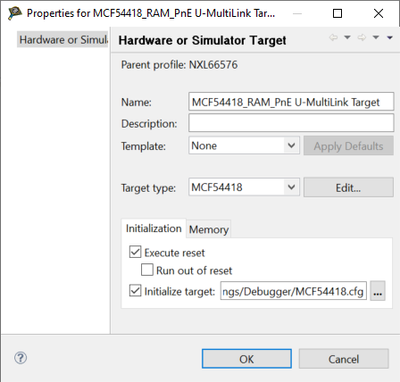

The default CodeWarrior for MCU V11.1 created MCF5441x project target is RAM.
That means only load image to MCF5441x chip internal RAM momory.
Customer need to set Flash target manually.

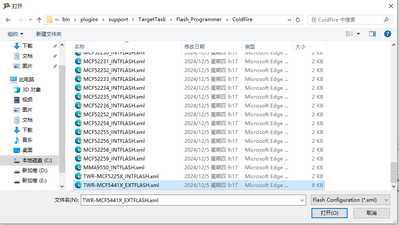

When custoer is using [Flash File to Target] tool, it also need to select correct board initialization config file and correct memory config file:

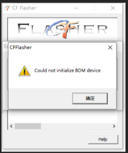

hi, I want to use multilink to do MCF5441x board external Flash programming with CFFlasher,
but fail.
what tool should I need, is it USBDM?
thanks
2,526 Views
Hui_Ma

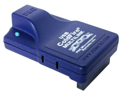

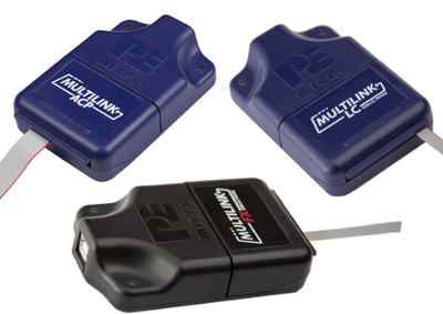

CF Flash tool is using P&E USB-ML-CFE debugger.
If customer want to use P&E Multilink debug probe, customer could try to use P&E PROG Flash Programming Software (PROG-HL-CFZ).
