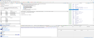

Hi everyone,
I'm facing a problem with my FRDM-MCXN947. What I'm trying to do is to boot an example program from the W25Q64JW external flash memory.
In order to do this, I've done the steps explained in the following user guide: Running code from external memory with MCX N94x - NXP Community
Also, I've managed to do the job also using MCUXpresso Secure Provisioning Tool 8.
With the led_blinky example, everything went well and the code is running correctly from the external flash.
So I've tried to execute a more complex example that involves ML/AI and TensorFlow Lite library. The example from the SDK is frdmmcxn947_mpp_camera_persondetect_view_tflm.My goal is to modify this example with a more complex model and so I need the external flash, because the 2 MB internal memory is not sufficient to contain my custom model.

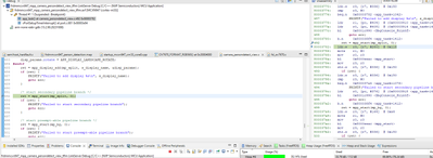

Using the example code with its defaul model, the code starts correctly but when reaching a particular instruction, then an hardfault is triggered.
Looking at the disassembly code, the hardfault happens here:
Is seems related to some malloc/free function into newlibNano library. I've checked the heap/stack allocation and it seems ok.

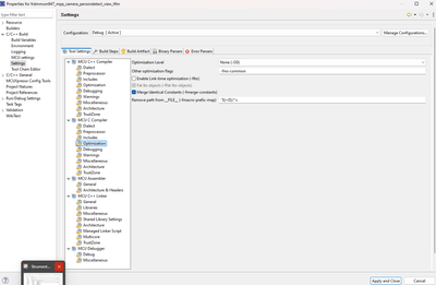

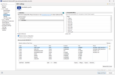

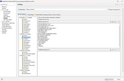

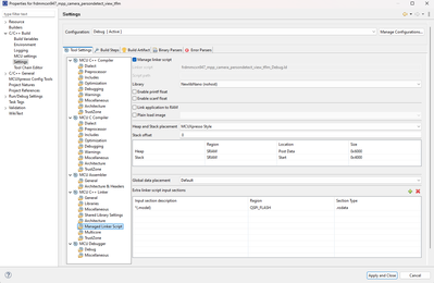

These are my configurations into the project settings:

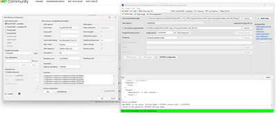

And this is the configuration from the Secure Provisioning tool
I've tried to change heap/stack size, changing memory placement, changing the newlib with redlib, but nothing worked and I'm struggling with this problem.
I hope someone can help me with this particular task.

I tried to use blhost to load the frdmmcxn947_mpp_camera_persondetect_view_tflm program into the external flash and succeeded. I recorded a video of the operation process and put it in the attachment. There are some precautions during the operation.
  1. I put the cmpa_bin.bin file in the attachment. By writing this file, you can configure the program to start from the external flash.
  2. The area of ​​the external flash erased by the flash-erase-region command must be larger than the size of the executable program.
  3. I have put all the blhost commands used in the attachment.
  4. If you re-enable the on-chip loader, you need to use the blhost command to re-load the cmpa_re_bin.bin file instead of the cmpa_bin.bin file.
Wish it helps you.

Hi, thank you for your help! With the video and the config files the firmware worked correctly.
I've understood what I was missing and the wrong things in my options. :).
I really appreciated your help and the amonut of the infos you gave me, thanks!
