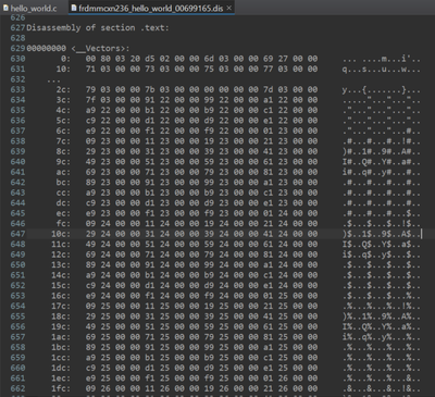

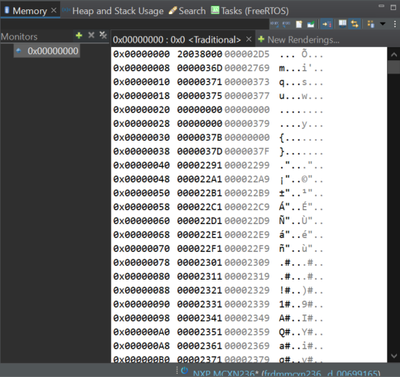

Fukuda
Hi @EdwinHz
The first image is a screenshot of MCUXpresso, and the bottom right shows a memory dump starting from address 0.
The second image is a dump of the axf file, with the initial stack stored at address 0 and the handler addresses stored from address 4 onwards.

EdwinHz
Hi @Fukuda,
I haven't been able to replicate this issue. When I try it, I get the same values for 0x00000000 on both the memory window and the .axf dissasembly:
You mention this discrepancy occurs in every project, but does it also occur on different workspaces? Please try creating a new workspace and downloading the image files from there. Also, try doing the mass erase using a different debugger if possible (like a J-Link debugger).
