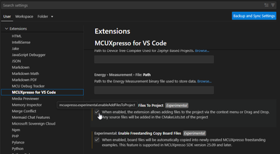

Harry_Zhang
Hi @tomdeboerio
We have implemented a drag-drop feature to make it easier for users to add sources to the project. It is currently available as an experimental feature that must be enabled by the user in the extension settings. This allows the user to simply drop sources into the project and the project's CMakeLists.txt file will automatically update.
To enable the feature:
  1. Open the extension settings
  2. Check Enable Add Files to Project
  3. Restart your workspace
For the hardware fault, check that there are no conflicts in the clocks, pin_mux, etc.
Last to enable custom boards (outside of the mcuxsdk repository) please follow the steps in https://mcuxpresso.nxp.com/mcuxsdk/latest/html/develop/sdk/custom_board_development.html#enable-a-cu...
Harry
