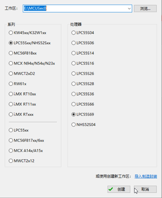

  1. Is there tool like flashmagic to program flash via UART ISP for MCXC242?  If no, How to?
  2. Does MCUXpresso Sec support MCXC242?  I found there is no MCXC series MCU. limit1995_1-1731404162652.pnglimit1995_1-1731404162652.png

marek-trmac
Hi Limit,
MCUXpresso Secure Provisioning tool does not support MCX C yet. It shall be supported in 2025 (release date not confirmed yet).

limit1995
Hi Marek,
So what could be used to program flash via UART?
