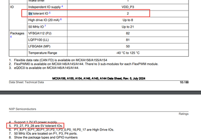

Which I/O pins MCXA153 (configured as input) are 5V tolerant?
best regards
Bogdan
1,952件の閲覧回数
Hello @bogdanurbanczyk
I apologize, but the MCXA153 does not support 5V tolerant I/O.
I recommend using the MCXA154, MCXA155, or MCXA156 instead. These parts support two 5V tolerant I/Os.
The difference is the flash size.
Hope it help you. If you have any further questions or need more information, please let me know.

1,946件の閲覧回数
bogdanurbanczyk
Many thanks,
