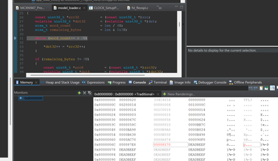

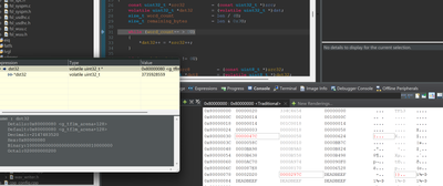

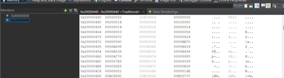

I use f_read first to load a 32KB chunk to the on-chip SRAM first and then copy the data from SRAM to external HyperRAM; I have checked the data in the SRAM and it seems to be correct. Here is the memory monitor on the SRAM range.
But when copied from the SRAM to HyperRAM I am getting data corruption only at specific offset, shown here:
I have re-run the program several times and the data corruption only occur at specific addresses, here shown at 0x30 and 0x7c, so it is unlikely to be a signal integrity issue. I think this is the same bit flipping issue as mentioned before. As mentioned, I am already not using cache for the Flexspi.
FYI, I have tested with some simpler R/W test with increments , (i.e. loops with i++) which is successful and the data I checked manually with memory monitor is correct.
I tried direct access and DMA method already which both result in the data corruption in the mentioned offset.

Harry_Zhang
Hi @TomC818
I think you can use byte by byte writing for comparative testing.
If there are no errors when writing byte by byte (i.e. there are no more errors at 0x30/0x7c before), but you previously encountered errors when writing with memcpy/32-bit, it indicates that it was caused by a sudden write width/misalignment.
You can force alignment, use byte writing, or adjust the write width.
