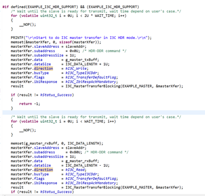

I tested the i3c HDR examples with two frdm-mcxn947 boards.
The related codes are below.
The channel 0 is SDA, the channel 1 is SCL, the channel 2 is Toggle.
We can see that the I3C_MasterEmitRequest(base, kI3C_RequestForceExit) can work.
Harry
