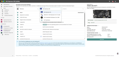

Hi i have bought FRDM MCxW71 for home automation project and am comfortable with S32DS is there a way to get drivers and build the project using s32DS
thank you
Labels (2)
1,732 Views
Celeste_Liu
Hello @Shreyas_Bhat ,
Thanks for your post.
You can download SDK from here: Select Board | MCUXpresso SDK Builder
Please refer to the figure below. Currently, we only support the following three IDEs(MCUXPresso, MCUXpresso for VSCode, IAR) for FRDM-MCXW71, which do not include S32DS. S32DS is designed for our automotive production line.
Thank you for your understanding.

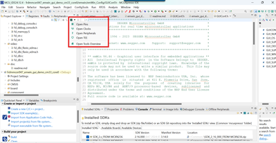

Is there a pin gui based configuration in mcxpresso ide
1,708 Views
Celeste_Liu
Yes, we have MCUXpresso config tools.
MCUXpresso Config Tools | Software Development for NXP Microcontrollers (MCUs) | NXP Semiconductors
After you installed the MCUXpresso IDE, you can find it here.
