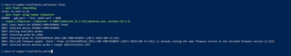

Hi, I am completely new to embedded development. I have got FRDM-MCXN947 micro controller where I wanted to flash a simple hello world application using Zephyr. I followed this link zephyrproject/frdm_mcxn947 to build and flash the board with the hello world application. All went well and here is the screen shot of output.
 I am not sure if this one flashed the board with the hello-world program.

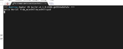

Then, I opened putty to see if I can get the Hello world printed in the terminal as seen here.
 I didn't see the above message in serial terminal and it's blank.

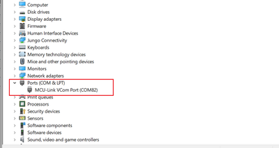

If you build the hello world successfully.
When you connect the mcxn947 board.
You can open the device manager to check which COM port.
And then config the console.

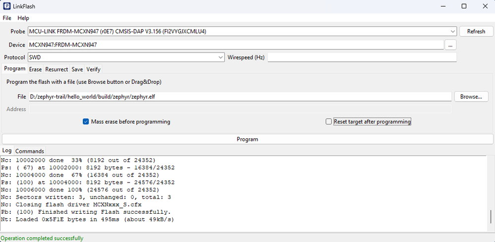

Also, I tried flashing the board using LinkFlash software. Here is the attached output.
Confirm me if I am on the right path. My putty serial terminal is still empty and not seeing "Hello world" message when I hit reset button.
