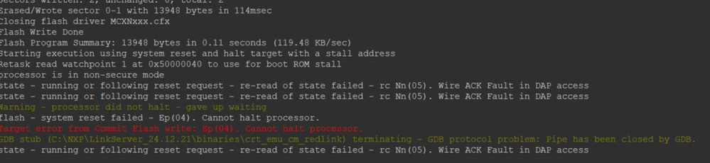

Hi, I am new to NXP board and MCXpresso IDE. I am using FRDM-MCXN947 board where I am trying to execute a simple Hello World application. I am not sure if I am on the right path. I tried with Zephyr example it didn't work or perhaps nothing came up in the Serial Monitor when I tried to print message there (HELLO WORLD) .
Now, I am trying with MCXpresso IDE where I have picked the Hello world example from "Import SDK examples"- build. When I clicked "Debug" I was able to see the board and probe however I had this warning.
I carried on with "Yes" and this started to Debug.

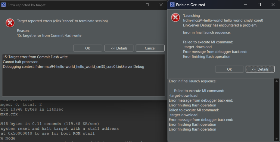

I had the following issue:
Can some explain me what went wrong? Thanks in Advance.

We can temporally ignore the warning.

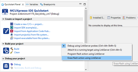

To re-gain debug access, boot the MCu into ISP mode and then trigger a mass erase. Easiest way for doing this is by using the debugger, over SWD.
 If you are having troubles, we can try to do a mass erase over LPUART/USB using the MCUXpresso Secure Provisioning Tool. You can also share a picture of your board jumper setup to double check settings and connections.

Hi, Thanks - it's working now.
