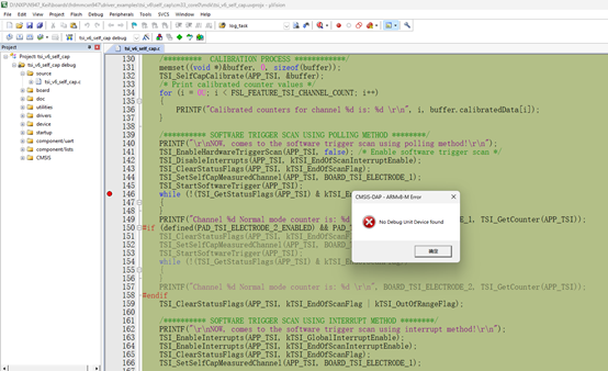

I flash my program via kiel a few times.I come across debug abort when i try to
debug.Then I lost my board, series port works well, but cannot flash new project

It seems that your MCU is temporally bricked.
To recover the debug access, please try to set the MCU into ISP mode, this way bootROM will execute, setting the MCU into a known state. Once it is set into this state, please try to do a mass erase and program your application one more time.

I use MCUXpresso Secure Provisioning Tool flash a demo successfully.
Program run normally.
But cannot flash KEil project bin file.Program doesnot run.
Still canont download file via keil or MCXpresso IDE
Program MCU-Link CMSIS-DAP - CNXPMCU-LINK_installer cannot updata debugger.
