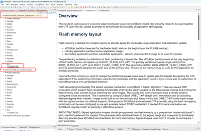

However, while testing the frdmmcxa156_mcuboot_opensource example from the
same SDK, I encountered the following log message on the terminal:
I have followed the tutorial from the official documentation here:
link
Could you please suggest what might be causing this issue?

Hello @CEPL_Dev
Thanks for your question.
Please use the two projects together: "mcuboot_opensource" and "ota_mcubot_basic".
For detailed steps, please refer to readme.md.
If still have issue, please show all your steps, I help you check.
Thank you.

Hi @CEPL_Dev ,
you can also use Secure Provisioning Tool, see step-by-step procedure described in the user guide: Generic workflows — MCUXpresso Secure Provisioning Tool 25.06
