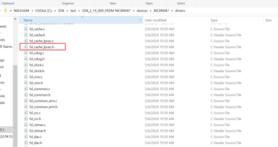

ge0rgeth0mas
Hi Harry,
Could CACHE64 be data cache and LPCAC be Instruction cache?
6,952件の閲覧回数
ge0rgeth0mas
Hi Harry,
I was going through the reference manual and SDK drivers as you mentioned:
I noticed theres is
* fsl_cach_lpcac.h which contains L1CACHE_EnableCodeCache()
and
* fsl_cache.h which contains CACHE64_EnableCache(CACHE64_CTRL_Type *base)
6,925件の閲覧回数

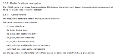

Harry_Zhang
Hi @ge0rgeth0mas
The CACHE64 module is used to cache FlexSPI accesses.
Based on  your need, you just need to enable lpcache.
Harry
6,964件の閲覧回数
Harry_Zhang
Hi @ge0rgeth0mas
You can refer to the Chapter 5 in MCX Nx4x Reference Manual.
Regarding cache related APIs. 
You can refer to the fsl_cache_lpcac.h in MCXN947 SDK.
Harry
