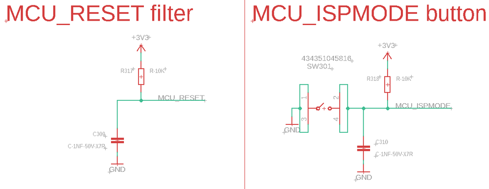

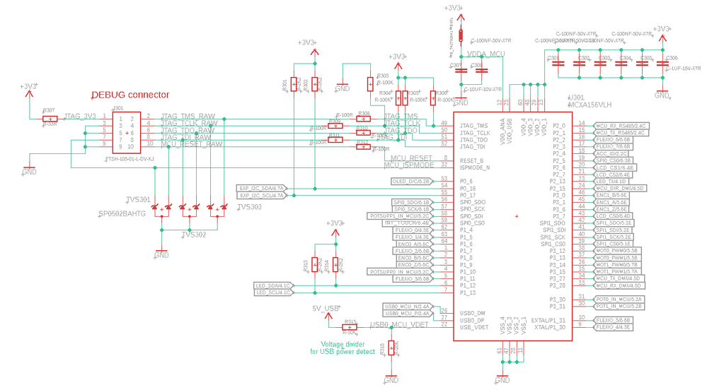

Following the MCXA14x/15x hardware design guide and FRDM-MCXA156 schematics, we designed a board with the MCXA156VLH. However, the MCU always enter ISP after power-up ignoring the ISP_MODE pin logic level.
Here are the relevant schematics :
We checked multiple times that the ISP_MODE pin is P3_29 on MCXA156VLH (the P0_6 pin is only routed to a pull-up).
Here are our observations :
  • The ISP_MODE pin is at 3V3 after Power-up
  • The MCU enters Master boot after a warm reset (button, debug, blhost)
  • The ISP_MODE stays at 3V3 after soft reset
  • We see the normal rise and fall (capacitor charging) on the RESET and ISP_MODE pins during power-up and button press

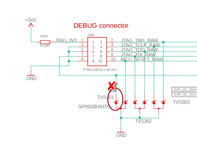

Hi @rj_engineer
Please remove the TVS connected to ISP pin to have a try.
Alice
4,132件の閲覧回数
rj_engineer
Hi Alice,
I removed the TVS and the behaviour remains the same, the board power-up in ISP mode.

rj_engineer
Hi Alice,
We have found the root of our problem.
The P0_6 pin was pulled-down at boot by a 10k resistor. Removing the resistor make the board boot normally (led blinking), soldering it back make the board boot in ISP (led not blinking).
What puzzles us is that the "MCX A156, A155, A154, A146, A145, A144
Reference Manual" and the "UG10151 MCXA14x/15x Hardware Design Guide" clearly states that the ISP pin is P3_29 for LQFP64 and lower pin count (obviously including our MCXA156VLH OP29K), The P0_6 pin act as isp only for higher pin counts.
Page 123 of the reference manual :
Page 9 of the hardware guidelines :
Can you confirm that this behaviour is abnormal?
