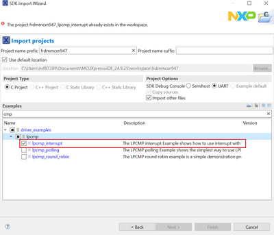

I would like to use a comparator in my project on FRDM-MCXN947, I want to trigger an interrupt in case the voltage at its input reaches 4.6V.
Is it possible to use the comparator on the FRDM-MCXN947 board in this way? If so, how is it necessary to set up the VREF, DAC and CMP modules in this case?

Hi @John_Adams
Based on your needs, i think you can refer to the lpcmp_interrupt demo in SDK.
Harry
