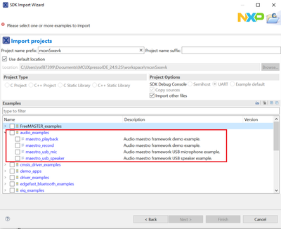

I was able to find the SDK and now have the VIT lib folder
I am trying to to take audio from an electret mic which is stored in a buffer via 16 bit adc sampling @ 16k. I think i can follow the VIT lib header file and user guide to create the program that calls the model but i cant work out how i  feed the audio from the mic into the VIT model i have created.
are you able to offer any advice on this ?

Harry_Zhang
Hi @ZoSo1872
The MCX-N9XX-EVK board is not connected to any audio related hardware.
So the MCX-N9XX-EVK SDK does not include audio relevant examples.
You can download the MCX-N5XX-EVK SDK.
It includes the audio example.
