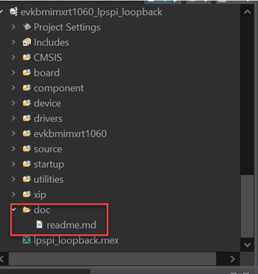

Hello @Jayaganesh,
In order to support you better, can you provide me the frame of all LPSPI signals?
Also, as mentioned in the table 14-5 called "System Clock Frequency Values" in the RM, the maximum clock source of LPSPI is 132MHz. Please take in mind this value. At the same time, the function called "CLOCK_GetFreq" that you are currently using in your code, receives an enum called "clock_name_t" instead "clock_ip_name_t" that is the enum of "kCLOCK_Lpspi1".
In the other hand, The SDK (version 2.16) offers the example called "lpspi_loopback" where you can corroborate if your board is working as expected, also if you have two RT1060's boards, you can use the SDK (version 2.16) example called "lpspi_interrupt_b2b_master" with "lpspi_interrupt_b2b_slave". I highly recommend see the readme of the example that you will use. Where is inside the folder called "doc", as shown in the next image:
