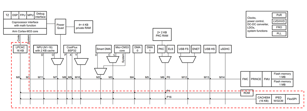

A key point about FlexSPI is that enables the SPI connected memories to appear in the system memory map. The details of the SPI transactions are managed by the FlexSPI controller. This feature enables Execute-in-Place (XIP) capability, where the CPU is executing directly from the external memory.
The FlexSPI controller has two ports which can be further subdivided into two separate interfaces allowing a maximum of 4 devices if required. SPI based memories typically are accessed in a burst mode, where a controller will read/write data in 512 bytes blocks. The block access nature of these memories can present challenge for typical MCU uses cases. The MCX N integrates a 64-bit data path, 16KB cache in front of the FlexSPI controller known as CACHE64.
The MCX CACHE64 Module
The CACHE64 provides spatial and temporary locality of FlexSPI data to the system, smoothing the block transactional nature of the external SPI memories. The cache makes SPI based memories suitable for direct execution or data storage without necessarily incurring a large performance penalty.

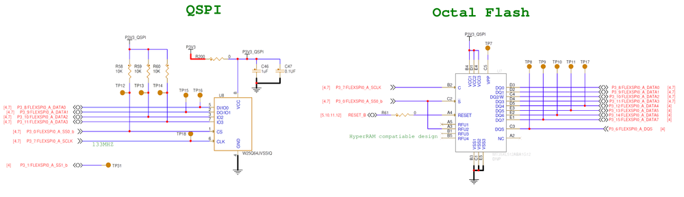

The FRDM-MCXN947 development board comes with a W25Q64 Quad SPI flash memory part installed. This part is packaged in a wide SOIC8 package.
The FRDM-MCXN947 Quad SPI Flash Configuration Default

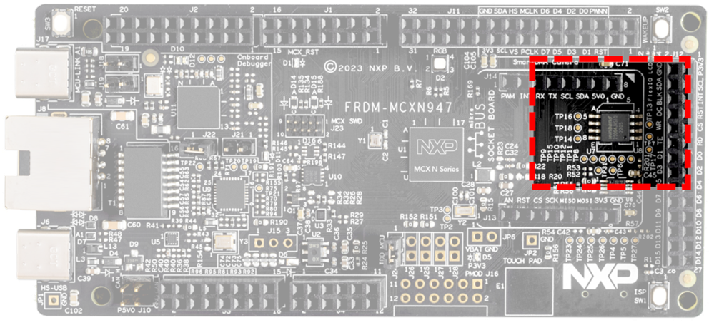

However, the PCB design has pads for attaching both QuadSPI devices in a wide SOIC8 form factor or Octal SPI devices in the 6mmx8mm BGA24 form factor.
The FRDM-MCXN947 Supports Wide SOIC8 and 6mmx8mm BGA24 Device Packages
I chose the 3.3v variant of AP Memory APS6408L as it was the simplest configuration to use with the FRDM-MCXN947. Removing the W25Q64 is straightforward with use of a hot air rework tool, exposing the BGA24 pads underneath.
Eli_H_23-1719236551153.pngEli_H_23-1719236551153.png Revealing the BGA24 pads on the FRDM-MCXN947
The APS6408L-3OBM-BA can be soldered with a hot air rework tool after adding some solder paste to the exposed pads.
The APS6408L-3OBM-BA soldered to the FRDM-MCXN947

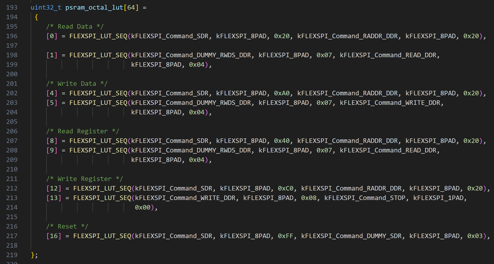

The FlexSPI memory controller was designed to be a future proof interface that enables the MCX N to interface with virtually any external SPI based memory. Using a programmable look-up table (LUT) approach, the FlexSPI controller can be adapted to single bit, dual, quad, or octal/DDR memories as needed. The sample includes a simple LUT to configure for the APS6408L-3OBM-BA.
LUT configuration for the APS6408L-3OBM-BA
PSRAM devices typically require additional configuration for parameters such as read latencies and burst sizes. This sample provides some defaults that will work with the APS6408L-3OBM-BA. Control register access is performed with the FlexSPI SDK API and the custom LUT.

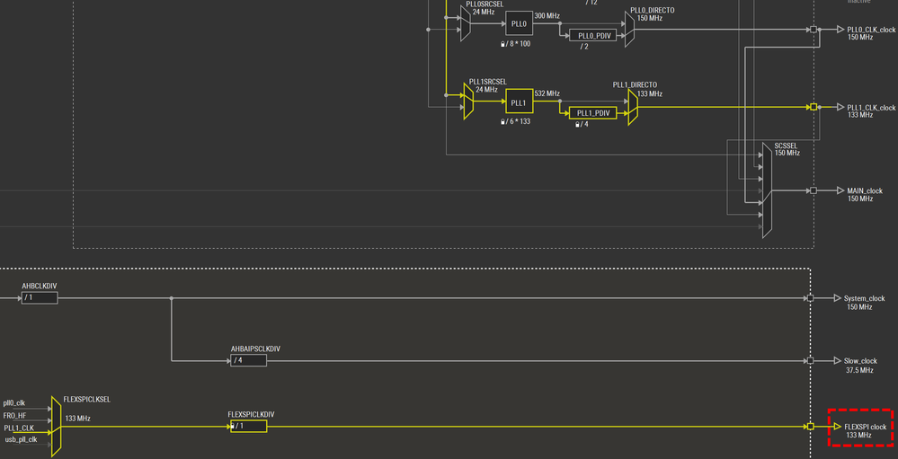

The APS6408L-3OBM-BA is specified for 3.3v operation and a maximum 133MHz clock. PLL1 was used to generate the 133MHz clock for the FlexSPI controller.
Eli_H_10-1719236203276.pngEli_H_10-1719236203276.pngConfiguring PLL1 to generate a 133MHz clock for the FlexSPI interface

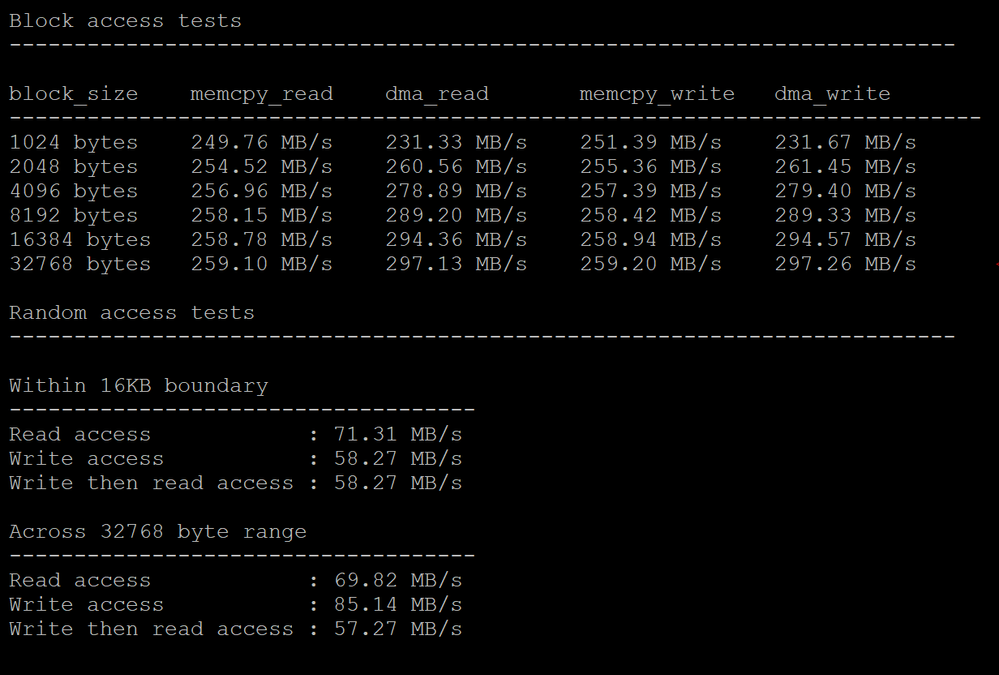

Eli_H_11-1719236203323.pngEli_H_11-1719236203323.pngThe memory control test using internal SRAM transfers
This test represents a control case as the source and destination buffers are both in internal SRAM and both of the buffers are in RAM banks on different AHB ports. There are many interesting features in the control data, but for now will consider this a baseline for how the test algorithms perform when using PSRAM.

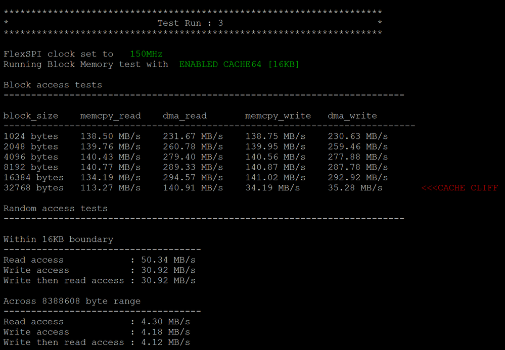

Eli_H_14-1719236203504.pngEli_H_14-1719236203504.png Test Run #3 : 133MHz FlexSPI Octal PSRAM – Cache Enabled
Test Run #3 returns to the 133MHz clock rate and enables the CACHE64 module.
A few notable features in this dataset:
  • The DMA read/write of characteristics match the control test. This is an indication that the CPU is primarily interacting with the cache, not the PSRAM.
  • Once the block size is larger than 16Kb,  we can see the read and write rates fall significantly. This is to be expected as this is the size of the CACHE64. When the block access is larger than 16Kb,  the FlexSPI peripheral needs to perform external access to fetch 512-byte pages (cache miss).
  • The random-access tests show that the using the cache when reads/writes constantly miss the incur a strong performance penalty.   When there is a cache miss,  the FlexSPI fetches an entire 512-byte block from the PSRAM. It is important to consider the use case to avoid this penalty.
  • Inside of the 16KB cache boundary, the random accesses performance is improved.

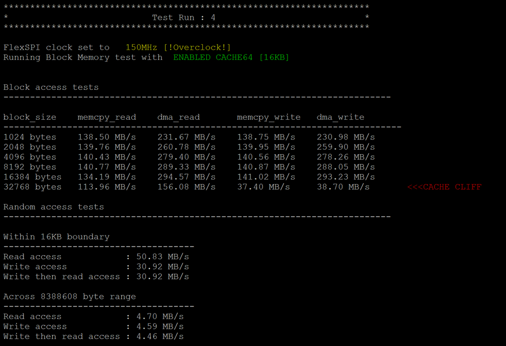

Eli_H_15-1719236203569.pngEli_H_15-1719236203569.pngTest Run #4 :  150MHz (Overclocked) FlexSPI Octal PSRAM – Cache Enabled
Test Run #4 is  a repeat of #3 with the FlexSPI running at 150MHz

From this initial data we can observe the behavior of the FlexSPI controller coupled to an Octal PSRAM through the CACHE64 using some limiting test cases. Real world performance will vary, but this dataset and code can provide a starting point to assess suitability for a specific requirement. These test cases show some of the performance boundaries, so it is to be expected that real world performance will fall between these limits.

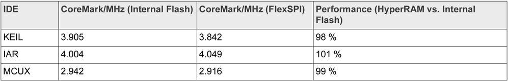

 NXP Application Note AN13591 provides data on XIP performance as compared to code executing from internal Flash:
https://www.nxp.com/docs/en/application-note/AN13591.pdf
Interestingly,  code execution performance is nearly identical when comparing CoreMark scores when running from Internal Flash, Octal SPI Flash and Octal SPI HyperRAM/PSRAM for the LPC5536
150MHz LPC5536 w/  MX25UM51345GXDI00 Octal Flash CoreMark Score  vs Internal Flash (From AN13591)
150MHz LPC5536 w/ W956D8MBYA5I Octal HyperRAM/PSRAM CoreMark Score vs Internal Flash (From AN13591)
