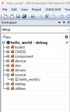

  3. Select the desired build target from the drop-down. For this example, select the "hello_world - debug" target

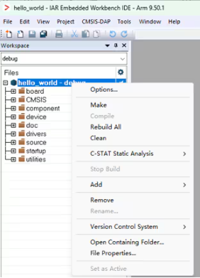

  4. Open the project properties by doing a right-click on the project and selecting "Options"

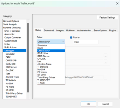

  5. Now, go to the "Debugger" section and change the debugger driver to CMSIS DAP. Press the OK button

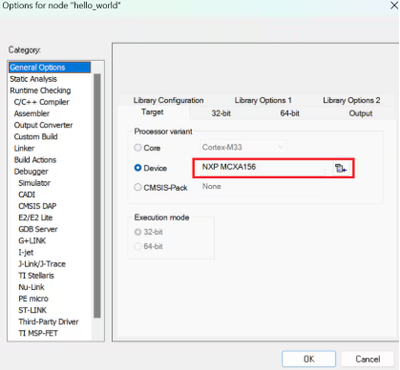

  7. The build will complete without errors
    Note: In case of building errors, make sure that the correct board is selected, right-click in Project → Options → General Options → Target → Device. Select the NXP MCU you are using and is supported by the IAR version you have installed.

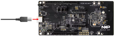

  1. Connect the development platform to your PC via USB cable to 'MCU-Link' port
